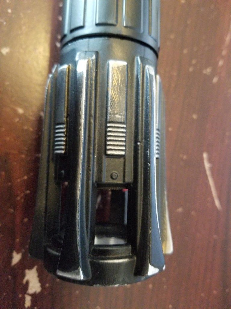

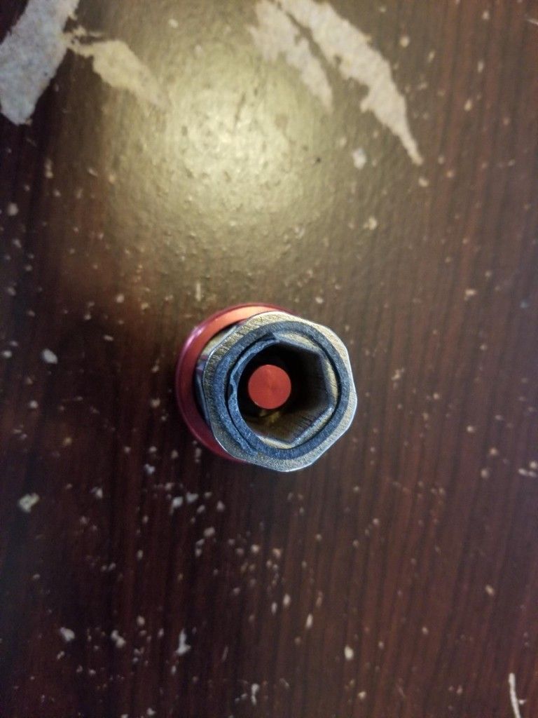

After reading Tom's posts on the TCS 28 mm 4W Wow speaker I ordered one and it came in this weekend so I went ahead and installed. It's slightly taller than the 28mm Bass Speaker I was using so I had to trim down the speaker mount a few mm, but it fits like a charm and it sounds so much clearer. I was running the bass speaker at 1300 and it was good but on the louder sounds it would crackle a little. I have the Wow at 1900 already and its loud and crisp with no trouble.  In addition to trimming the speaker mount a little bit I also removed the top foam gasket from the speaker and attached it to the pommel insert, since the speaker is slightly offset it made more sense to isolate from the insert to reduce vibration. The gaskets are just held on with a double side tape and they have two on the Wow speaker, I carefully removed the upper on and added to the insert.  The speaker fits perfectly and sounds great.
