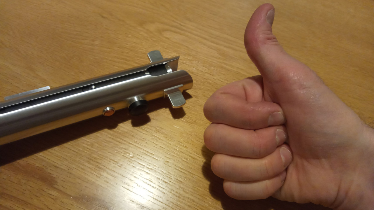

However on the large, the assembly video does not show how to attach the bunny ears to the large. Is the intention to adhere them with an epoxy, like e6000? I don't believe these need to ever be removed, even to remove the inner black tube, can something stronger be used to adhere it ? Yes, I use loctite 648. The green colored liquid. 72hrs for max hold, I think it was. You'll want to apply some pressure during curing. I use thick rubber bands. Wipe the surfaces with acetone and you'll get a good solid bonding. And yes, you're correct. These don't ever need to be removed so you could even braze them on if you've got experience doing that. Guys,some emergency advice please.I bought the installed versions through Korbanth & with an unlucky knock,one bunny ear came off.Have tried the above Loctite 648 solution & no joy- cleaned both surfaces with acetone prior to application,used the Loctite,applied heavy rubber bands for pressure.But 72 hours later,the bunny ear & hilt still part company with ease,& it appears the Loctite hadn't even begun to set- wiped it off both surfaces,still wet. Hadn't used an excessive amount at all,& the hilt's been undisturbed since the attempted fix... what am I missing? Please help,this set was for my girlfriend,they're her unicorn sabers,& the damage was my fault! 😣
Post by Obi-Shane on Feb 17, 2020 0:39:31 GMT -5
Yes, I use loctite 648. The green colored liquid. 72hrs for max hold, I think it was. You'll want to apply some pressure during curing. I use thick rubber bands. Wipe the surfaces with acetone and you'll get a good solid bonding. And yes, you're correct. These don't ever need to be removed so you could even braze them on if you've got experience doing that. Guys,some emergency advice please.I bought the installed versions through Korbanth & with an unlucky knock,one bunny ear came off.Have tried the above Loctite 648 solution & no joy- cleaned both surfaces with acetone prior to application,used the Loctite,applied heavy rubber bands for pressure.But 72 hours later,the bunny ear & hilt still part company with ease,& it appears the Loctite hadn't even begun to set- wiped it off both surfaces,still wet. Hadn't used an excessive amount at all,& the hilt's been undisturbed since the attempted fix... what am I missing? Please help,this set was for my girlfriend,they're her unicorn sabers,& the damage was my fault! 😣 That's really weird. Other then the locktite being some bunk knock off version or expired in some way the only thing I can think of is your surfaces didn't get clean enough. Sounds strange even as i type it that glue can expire but i remember some e6000 I had that just wouldn't work after having it some years. Unsure about super glues tho. Give it a very good cleaning one more time, check for residual glue residue and remove it, a razor knife used carefully is very effective this way. Avoid scratching up the surface of the hilt. Apply the green locktite to both surfaces and press it on, then use the thick rubber band method as pressure. Then grab a cotton Q tip and some rubbing alcohol and clean up the excess around the edges that gets squished out. Also make sure you are letting it sit in room temperature and not in a cold garage or workshop. Keep me posted.
Post by Guylo Ren on Feb 17, 2020 14:07:15 GMT -5
Cheers,Obi-Shane.By consensus at this end we're already trying a second attempt as you specify,so will see if it's worked in a couple of days. Incidentally- bought the 648 new from Ebay,but having now checked the outside of the bottle found a 10/14 on the bottom,which suggests it is indeed expired,but plenty of Loctite reviews claim 20-year-old bottles still work... The bottle looks a genuine one,smells like every Loctite does,so I dunno. Have also been recommended epoxy (specifically Araldite) by several folk,& an engineer at work even said superglue would be better for the purpose- we do actually use one that glues resin RFID chips into steel karabiners,it's a Loctite too (485,I think),so if the 648 doesn't hold this time will try one of those instead.
If nothing else,my calamity serves as a useful saber adhesive research article,I suppose.😞
Post by Guylo Ren on Feb 19, 2020 15:06:55 GMT -5
So,update on the Ahsoka repair...  ...it appears we have success!😃 Cheers for the advice,Obi-Shane,the Loctite seems to be holding on second attempt! Used a double dose of big rubber bands this time,but I had also already risked a careful Scotchbrite scuffing of the surfaces to be adhered (prior to your reply) to provide a key for stickage,& whichever factor has worked the bunny ear now seems immovable. Balance is now restored to this beautiful set of hilts,a huge thank you to Solo's Hold for this run- fine,fine work under very difficult circumstances,sir.We salute you!👍🏻😁👍🏻
